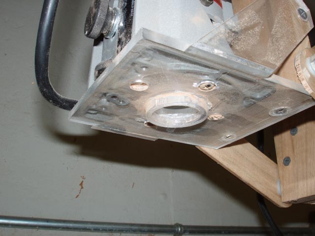

Hesh, your jig will work fine but I would invest (time and materials) in a "doughnut" so that the router will not ride up on the dome of the back/top. Basically it just allows the base to have about 1/4" to ride on.
Send me a PM if you need help making it. Chances are pretty good it could find it's way in my car on my way to Montreal.

Hesh, I'm not Paul, but I believe he's referring to the donut shaped part that is mounted to the bottom of the base, with the bit protruding from the hole in the middle. The donut is the contact area between the guitar top / bottom and the router. Because of its small size it will not lead to a change in the angle of the cut as the router moves along the guitar rim (where the angle between the sides and top / bottom vary according to the plate's dome and the guitars outline) as a larger router base will.
The donut on my trimmer base is a simple steel washer, but it accomplishes the same thing.

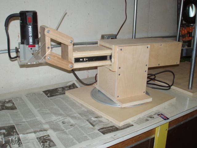

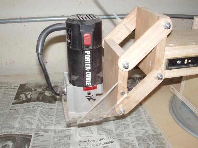

Like Paul, I feel more comfortable moving the router.
I built a jig like Arnt's (which is really impressive!), but the old saying about
fool-proof" was coined for guys like me. I found a way to screw up the operation of that jig. It is inherently top-heavy, and I was able once (or twice) to let the bearings slip away from the side...the router tipped in, and made a deeper cut than wanted.
I then made a jig like the one I hope to picture here.
It came from LINT and enjoyed several incarnations. Hope this makes sense:
The design is borrowed from those armed lamps that move about on the workbench, while holding the lamp in the same plane. This jig just holds a router.
